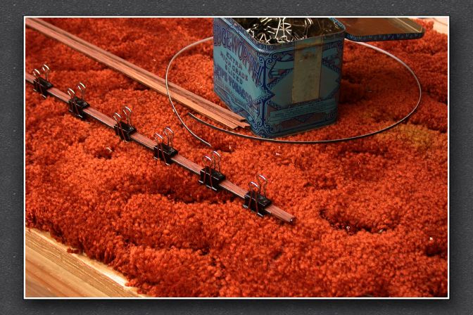

I`ve had trouble with purflings wanting to twist when applied below the bindings on the sides of the guitar.Especially in the waist.I`d like to pre bend these.They are just your typical B/W/B commercial purfs.Can I glue them to the wood bindings with CA and then bend in the bender or how do some of you folks do this?         & nbsp;     James

That's what I've done. Works well.
I run a thin line of CA along one seam.
PostPosted: Thu Jun 28, 2007 9:39 am
Also, after gluing, tape pairs together tightly every few inches so the purfling strips get pressed against each other, then cook 'em in the bender.

I do pretty much the same, although I use titebond instead of CA. I didn't want to risk gluing my fingers together while fussing with the purfling.

I titebond the purf to the binding, sand them to .080, tape them together, just a little water, wrap them in aluminum foil, put em in the bender.

I use titebond 3 for this operation as it's and it holds up great under the bending process, better than CA in my experience.
